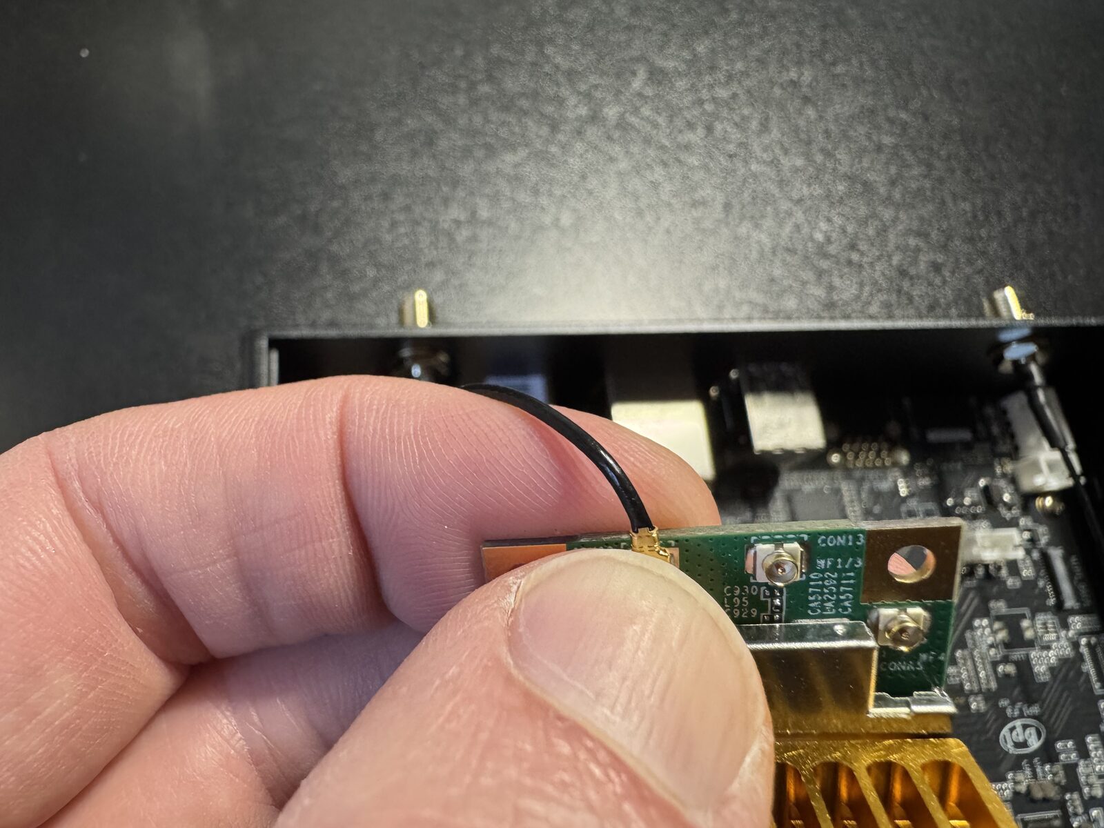

The antenna connectors are tiny and delicate. They snap on by pressing straight down and come off by lifting straight up. Never pull on a wire to remove its connector, never press at an angle, and never force one. If it doesn't click on, lift it off and line it up again.

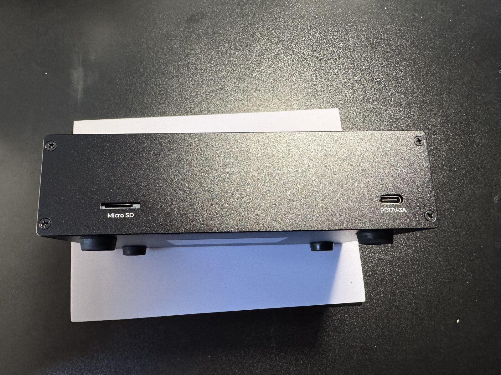

2. Remove the four screws on the front
Use the screwdriver from the box, and put the screws in your bowl.

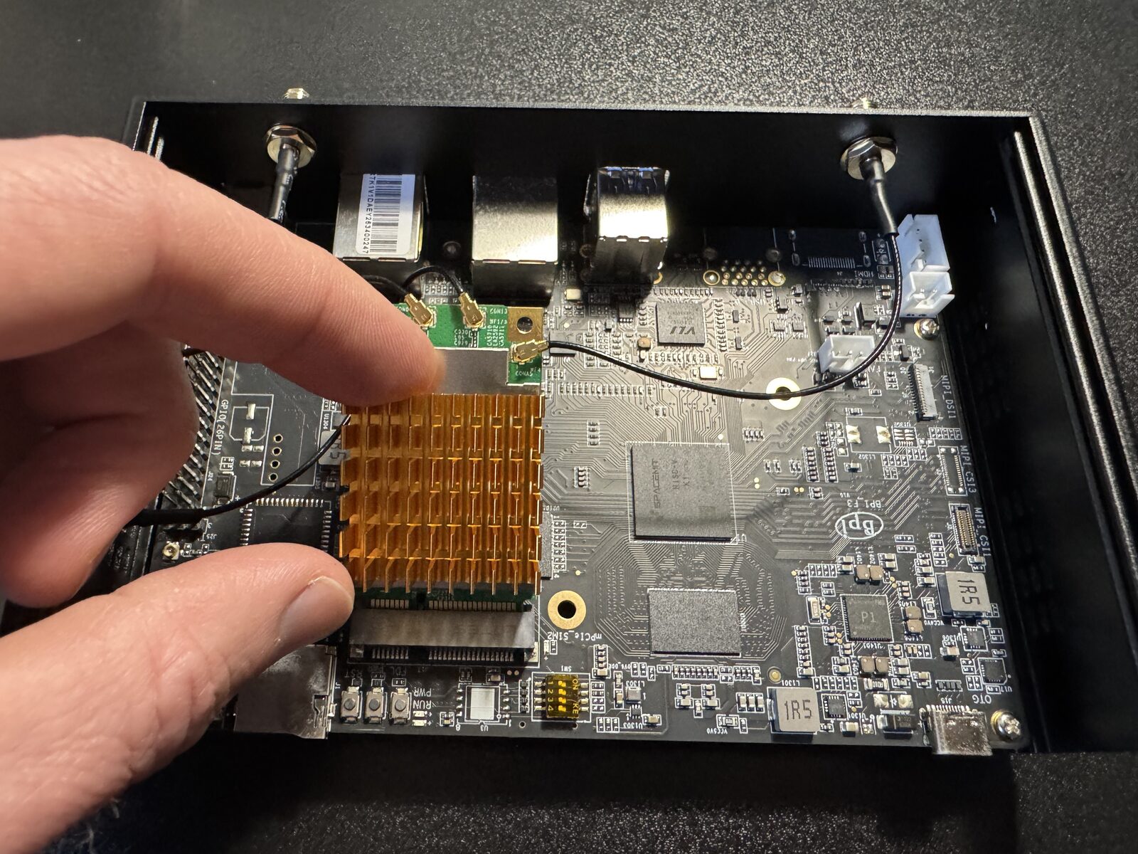

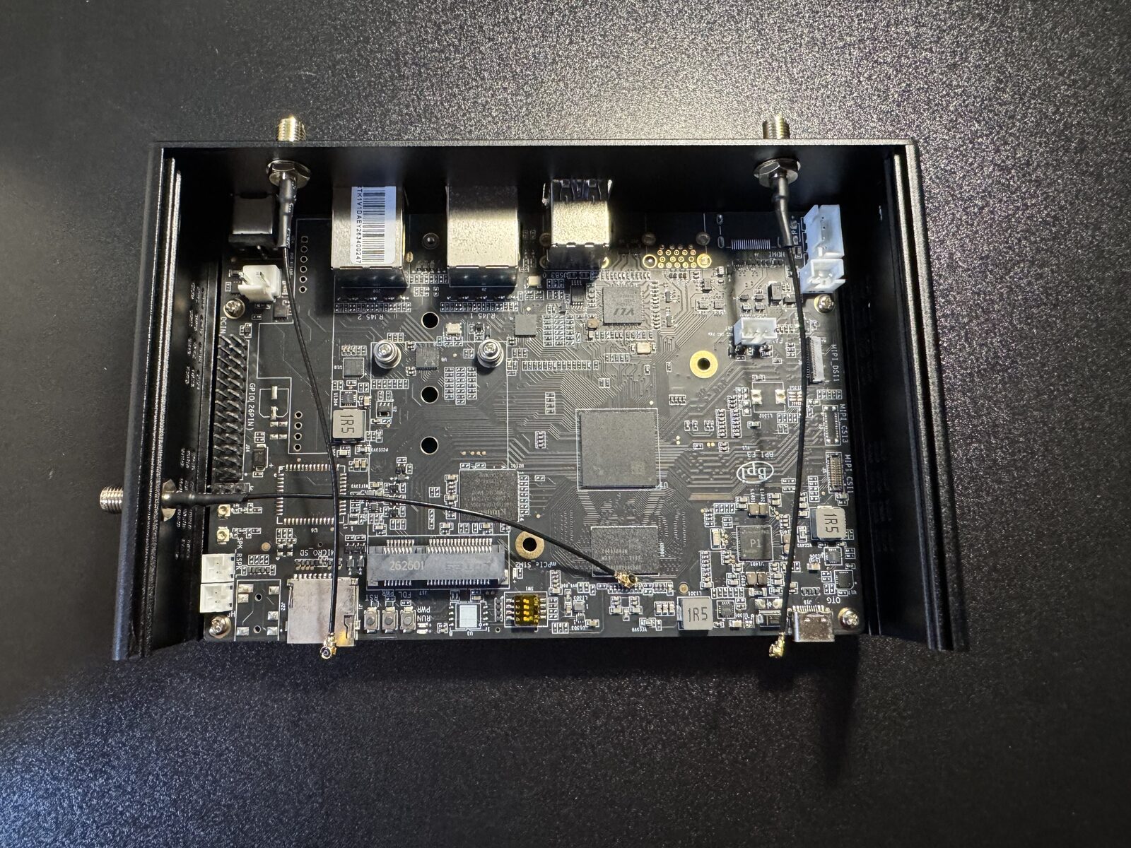

3. Slide the top off
The top slides off easily. Inside you will see the empty mini PCIe slot and three antenna wires hanging loose from the antenna mounts.

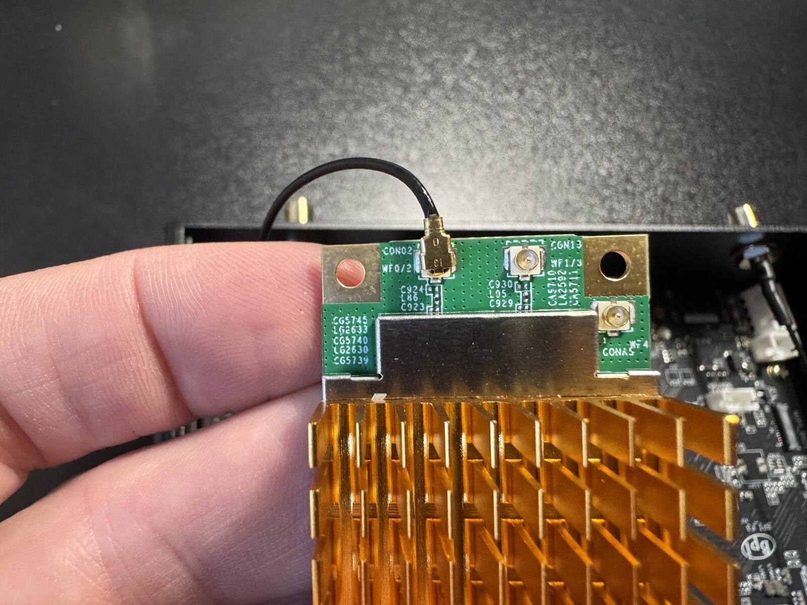

4. Attach the three antenna wires to the module
This is the fiddliest step, and it is easier with the module in your hand than in the router. Touch bare metal, take the module out of its bag, and hold it by its edges. For each wire, set the connector squarely over one of the module's antenna sockets and press straight down with a fingertip until it clicks. A seated connector sits flat on its socket.
If your module has fewer than three sockets, leave the extra wire unconnected and tuck it away from the board.
5. Insert the module into the slot
Hold the module at a slight angle, with its gold contacts toward the slot, and slide it in until the contacts disappear. Then press the free end down flat against its screw mount. It only fits one way; if it doesn't go in easily, check that the notch in the contacts lines up with the slot.

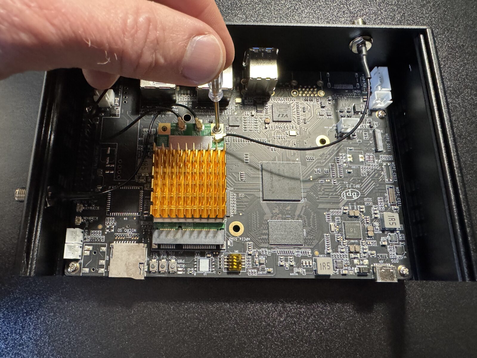

6. Screw the module down
Use the same screwdriver. Snug is enough; do not overtighten.

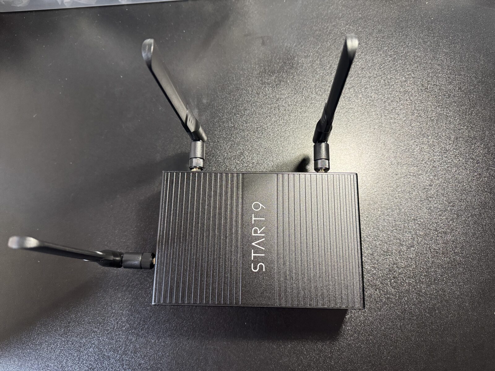

8. Screw on the antennas
Screw an antenna onto each antenna mount, finger-tight.
